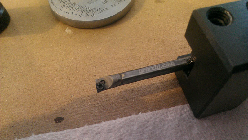

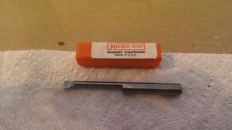

I use a carbide shank Grizzly boring bar. Will enter a .236" hole. Micro 100 boring bars are an option too, but find they are just a tad bit too short to bore the entire length of a Harrells brake. The Grizzly bar is nice, but pricy once you add in the inserts!
"I use a carbide shank Grizzly boring bar. Will enter a .236" hole. Micro 100 boring bars are an option too, but find they are just a tad bit too short to bore the entire length of a Harrells brake. The Grizzly bar is nice, but pricy once you add in the inserts!" - ridgeway quote.
I've been to Big G's Bellingham, WA showroom a couple of times and looked at those mini bars. Nice equipment, but having to by 10 or 12 inserts is a no go for me. Don't know why they won't sell just a few?
+1 with ridgeway. I use the grizzly bar as he has pictured. The boring bar is of good quality and as he mentioned is pricey. I have a circle boring bar as well and it seem to be very good quality, but is a little short for the longer muzzle brakes, sure they may have what you need as well.
