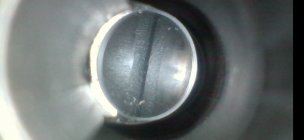

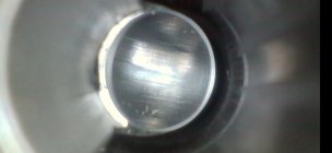

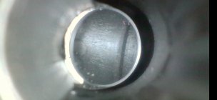

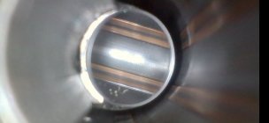

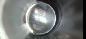

I've been shooting my gas guns quite a bit lately...particularly my 16" set up with iron sights to add some flavor in my life. I've put a few hundred rounds thru it since I brought it out of the safe, where it was cleaned thoroughly down to metal. Exclusively using h335.
Last week when I got home I noticed the barrel was still warm, not hot but luke warm, so for s&gas I oiled up a boresnake and gave it a few pulls....I ran borescope thru for a quick peek and low and behold, it removed almost all the visible carbon leaving only copper, interesting. Last evening I went out and shout another 120 rounds thru the 16" and about 50 thru an already heavily fouled 12.5 sbr., again running the boresnake thru the warm barrels and once again almost all carbon removed.
It makes sense that heat softens up the carbon some making it easier to remove but had no idea to what extent. I am going to try this method again with a pretty carbon fouled bolt gun and hopefully see same results, but so far using the boresnake as an intermediate quick step between deep cleans on a warm barrel is seeming to work.
Chamber pics of 16" after warm snaking.

12.5"
