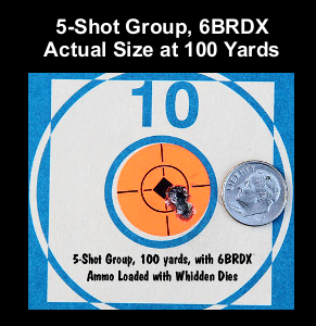

Different strokes for different folks. There are as many functional cleaning methods as there are barrels. But this poster's method seems like an awful lot of work. With my best barrels, after 35 rounds or so, I send 4-5 soaking wet patches (Shooters' Choice or PatchOut) through the barrel to get the loose "soot" out. Then I apply Wipe-out from muzzle, let it sit 20 minutes, then re-apply. I plug muzzle and breach and drive home. After 3 hours I send 4-5 dry patches through the barrel and put the gun away.
Yes, other barrels may need brushing... Yes I know that Tony Boyer and other Demigods brush the snot out of some barrels... but 25 brush strokes seem excessive to me. I do acknowledge each barrel is different. I suggest that people find the least invasive cleaning method that keeps their particular barrel at peak accuracy. I also think there is some evidence that leaving petroleum products in your barrel may exacerbate carbon issues. Here's a five-shot group with my latest Brux that has never seen a brush:
