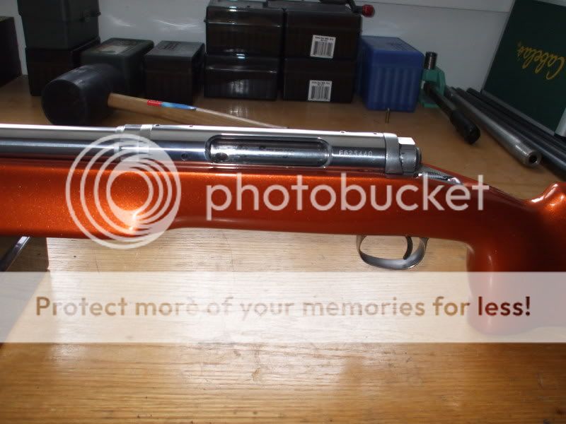

that is a very very nive looking rifle you have there. Description?
rdmyofb said:
Samdweezel05 said:
The top of this picture you will see what the bolt looks like once you have taken it apart. This is what it needs to look like to get the bolt head off.
Savage target action, Lothar Walther barrel chambered in .22-250AI, 28", strait cylinder, 11* target crown, stockade long range bench rest stock painted Atomic Orange.
