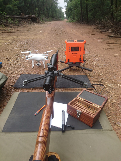

Do you fly the drone done to look at your target?
Haha yes I was shooting a ladder and the way the range is setup you cant really see the bottom half of the target with all the brush around over 500y. Set the drone to hover around 25y above the target and then just drop it down and take a picture after every shot. Really makes shooting a ladder allot of fun without any problems of marking shots.
