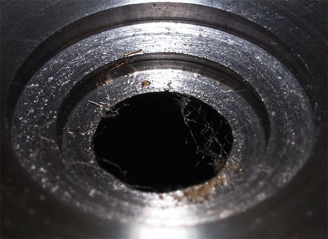

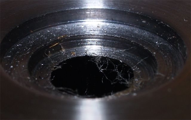

I went through two XR-100s in 204, and neither were accurate - their best groups running ~1" and going down hill from there.
But I loved the little single shot receiver, and I wanted a 20 calibre rifle, so I decided to go with a 20 Tac, because of the availability of Lapua brass.... but I had no reamer and this would be a one time deal, so I didn't want to buy a reamer.
I asked around and gunsmith "KW" had an excellent reputation in 20 caliber rifles. I recognised the name - mosts people would.

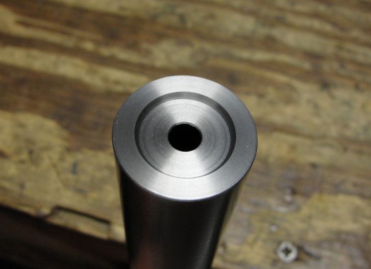

I wouldn't trust anyone in Connecticut to cut a match chamber, so I sent my second XR-100 barreled action, and a Kreiger 10"-Twist truck axle off to "KW", with instructions to finish it to 26" and put a flat stepped crown on it - I even sent him a picture to make sure we were on the same page., so he couldn't get it wrong!!
Well, in time (longer than promised), the barreled action comes back (without my original barrel :( :( )... and I try to drop it in the stock, and it won't go - the recoil lug is off to one side about 20 degrees (Gag!!)... but I can fix that, I have the tools and lug jig, but then....
... I look at the crown (Gag-Gasp x10), and I am shocked!!
It was wrong, and cut with a dull cutter, and it gets worse (can that be possible??)
He cut the crown from the outside of the barrel, to the inside, into the bore, so there was a roll of steel pushed into the bore - large enough that I took a paper clip and hung a bunch of keys from this ring, which was INSIDE of the bore (Triple Gag-gasp!)
I shot the steel ring out, and I will re-crown it myself this summer...
... but I do not assume that big names guarantee good work.

The crowns sure looks different under magnification, the first crown has two steps and the second has three.

Of COURSE they look different ??? ??? ???
The two are NOT the same - as was clearly explained, the first picture is a two step crown, and was a picture I sent to the "gunsmith" so he would clearly know what I wanted.
The other pictures are the three step garbage crown that he produced on my barrel.
