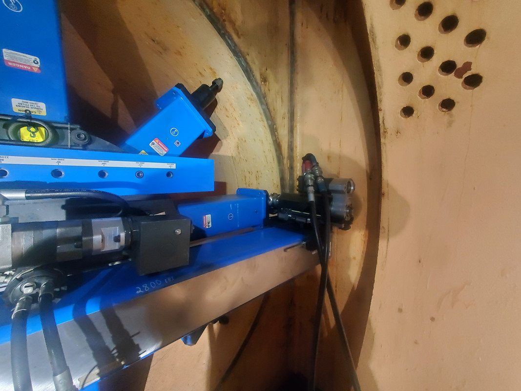

Big Dredge Boat Boring Job
Ours is made by climax. We had the runner clearanced with one. For perspective, those are men on top and this drops into the finished bore. We have the luxury of a warm dry place to work and endless crane support. I miss some of the field fabrication of the setup.

Jackie, what's the life expectancy of those bearings?
Al, it depends on the conditions the vessel operates in.
Vessels that run in clean river water or clean offshore blue water can expect 5+ years of service from Rivertough Bearings.
Vessels that run the Intracoastal Waterway System, where the water is usually shallow and brackish, around 3 years can be expected if the boat sees continuous service.
