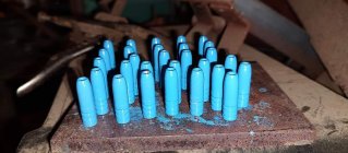

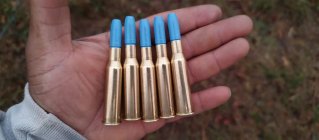

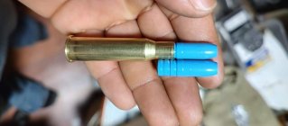

Something I've been playing with in my old bubbaed sewer rod. Not a MOA. Rifle not trying to make it but it's sat on the wall for the last few years, found a mold I liked and figured I'd make it into one of those deals where it's just kinda a 100yd and in meat gun type of deal. Been a fun little learning experience so far since it's the first 30calnive tried to cast for.

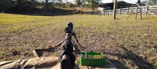

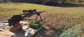

Tried shooting my first loads off my tripod because of the rain but after tryin to get a cow out of the way I could barely see so ended up shooting this wonderful group @50...which for some reason is what you supposed to do load development with cast at. Don't really understand it but it's what everyone the cast community does so :D

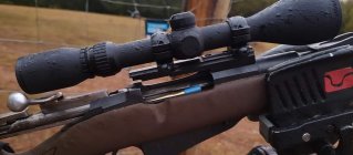

Tired again the next day but after shooting all 20 test loads I found out my scope rings where loose ...was wondering why I couldn't keep on target. Also noticed I had leading for the first time in my little casting career. Confused me because I used basically the same methods to shoot cast out my 5.56 ar at up to 2500 with no leading.
Well after I scrubbed it all out went down the check list and only thing I could think of was my alloy. I got some sheet lead to play around with and had been adding it to my mix. Figured the little I added wouldn't hurt.... Well checked one of my bullets from that mix and instead of the usual 16bhn I start off with I was at 6bhn....way too soft.
So that explained that made a new batch with a harder alloy along with water quenching after dropping out the mold and after powder coating , got it up to 15 today

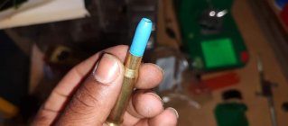

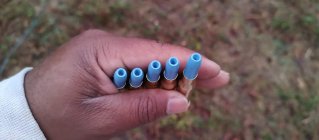

So lil info on the gun. It's a old hex receiver Mosin. Kinda a pitted bore, but the trigger had some work don't by the former owner and it's pretty nice at like 2.5lbs I think. Bore slugged at .313 last time I did it so figured it would like some bigger stuff hence who I got a .316 dia mold. Figured it's easier to sized down to where I need vs trying to size up. That being said I forgot to order a .315 and .316 sizing bushings so I'm stuck sizing to .314 right now. Really need to get some chamber casting alloy too because I have no clue what's goin on in the chamber really. As far as the bullets go I cast, water drop , size and gas check ,dry ,powder coat then water drop again then a final sizing to make super they stay .314. running IMR 4227. Really should have picked up some 5744 but slipped my mind . Not to mention that crap is about as expensive as varget.

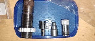

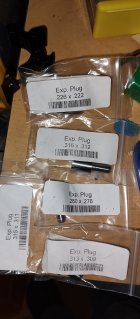

Now I also use a NOE expander plug instead of the lee system. You guys who mess with sizing mandrels can probably get the jist of what these are.

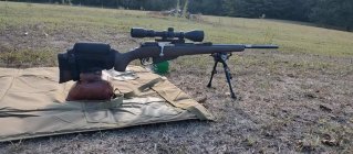

But yeah set back up today and was only able to get one group in but it's an improvement from the first. Not too loud and light recoil to boot

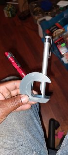

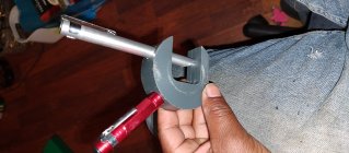

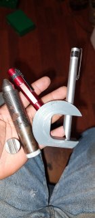

If you have time, could you explain about the devise you are testing hardness with? I am going to need to get into this soon as I want to cast rifle bullets as well as the handguns i am doing now.
NOE's expander setup is slick, use them for every caliber I cast!
For me, the Lee tester is too finicky so I went with the Cabine Tree tester instead.
Sure ! All it is is the lee harness tester with this little 3d printed stand . I bought it used and it came with the stand. Makes life easier because all you have to do is really move the bullet instead of trying to be an octopus and hold the light microscope ect. It work but honestly I'd go with a nicer system if you can .

Thanks, I looked up the Lee tester but just saw the metal parts , the stand had me confused. I have mostly soft lead but have some wheel weights that I cast as ingots and are mixed in with the soft stuff. At some time I need to up my game and separate them and learn to make a harder alloy. Soft lead and tin 20 to 1 seems to work for my 38 spc loads and I have a bunch of 9mm loaded but my eyes were stopping me from wasting it. But now i have eyes again.
