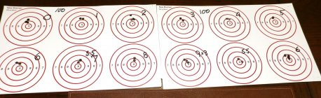

These targets were shot at 100' 6br 28.9 Varget, br4, 108 bergers flags. The gun was shot with settings from 0 in to 9 in increments of 1. 1 to 9 is a full revolution. They didn't seem to print around in a circle like described, nor did they seem to repeat Targer 12 was a repeat of # 6 using sighters of different B-O measurements Ideas? ps numbers on the target are tuner settings.1756349328968.jpeg
Reshoot #6 but with B to O differences it invalidates your results. Sort bullets and try a different bullet also. Why your point of impact does not change a bit baffles me, but that is not important.
Erik says go 5 marks but then he also says to go back and test on either side of the number or numbers that looked best.
That certainly seems to make sense.
The things that don't make sense are as @JEFFPPC noted, there should be some noticeable changes in POI as the OP dialed through the settings. This makes me believe something may have skewed the results.
I notice the OP says distance to target 100' and when I was in school that was the sign for feet. was this at 100 feet or 100 yards?
Also, were wind flags out during the testing?

oh my I meant 100 yards sorry
