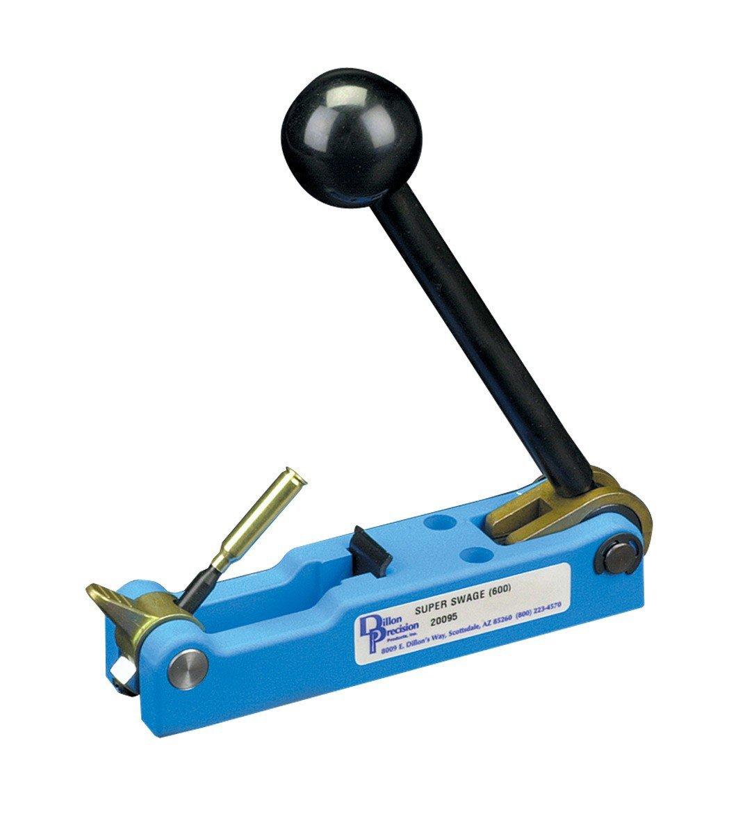

General consensus is to spring for the Dillon:
I prefer to ream them out. If you are swagging different head stamps, The will vary in thickness. If you wan to swag properly, you will have to sort by headstamp and then have to adjust the swag for each as well. Its a PITA.
If you ream them, head stamp doesn't matter. Several manufactureres like RCBS, etc., make them for very cheap.
I much prefer swaging the pockets. I recover a lot of brass at the range. For those that the crimps were cut out, probably almost half were cut WAY TOO DEEP. Not saying it can't be done right, but my experience says many don't.
A primer pocket reamer has a fixed depth. Guys that use a countersink or deburring tools can't control the depth and tend to ruin a lot of brass.
100% agree, I have the Dillon swage and I think it's about the best. I used another one that a friend had, but it wasn't built nearly as well as the Dillon. In my experience the reaming doesn't work very well at all. I don't tend to use crimped brass these days, but when I was shooting 5.56 it was common to find/buy lc military brass. When I was shooting 600 rounds a month it made sense.
My suggestion to the OP, spare yourself a happy meal and get some match brass.
EDIT: in re-reading the OP, I see you're using a Dillon press. The worst experience I have had on the Dillon is using crimped brass and not seating the primer properly. The powder drop makes a huge mess on the plate, it takes me about 30 minutes to clean up properly. The Dillon swage will save your bacon, but I would still look at buying Lapua/Peterson brass, even if you buy it used...a lot of that stuff around at this point for 5.56. The RCBS Lockout die is also a bacon saver on a Dillon.

I use the Dillion swage. Must have got lucky, Bought used and the setting seems to work with every thing I have run thru it. Also if/when you no longer need it, you can sell it for what you paid or maybe a little more. Bolted mine to a piece of 2x6 about 14-16 inches long, pull it out as needed and plop it down on the bench top. Just be sure to mount it so the handle clears the 2 by!
Frank
Dillon once set up correctly is a Breeze and the feel of primers going in is perfect after
Just takes a little to learn the tool --Can do high volumes easy once set up
I have done both. Swaging still left a bit to be desired, cutting left a nice beveled edge and helps start primers easier.
