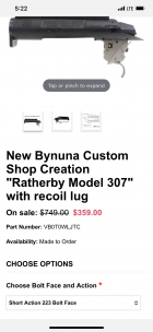

I acquired one and could not be happier. 700 footprint, side bolt release, Sako type extractor, fluted bolt, threaded bolt handle and oversized knob provided. All for 539. The Drakker action, kind of looks like a Stiller
Screwed in a 223 barrel originally headspaced to a 700 action. Got extremely lucky, headspace checked out without any adjustment. Rifle even shoots fairly decent for a suppressed Whitetail hunting rifle.
Hand down, no contest on VALUE here for an EXTREMELY DECENT action for the $….better than any Rem 700 factory action I’ve worked with. FULL STOP.
Kauger, Mack, Pure Precision, Alterra, Defiance are all over double this $. Out of the rest just mentioned, pick one, they’re ALL good! Really like Borden and BAT and the GunWerks too, but they do not have a budget offering. Gunwerks had the GRB, but they apparently are no longer selling components.
IMO there’s nothing close to that PTG/307 knockoff for that price right now. No contest whatsoever. The question remains on how long you’ll wait, communication, etc….i have used one so far, and have 6 more on the shelf in all iterations of 223 bf, a sa 308bf, sa mag bf (2), and La mag bf(2). Are they the best out there, heck no. Are they a value/budget action that will work perfectly well? Heck yeah. If you’re interested in an awesome budget barrel that with some machining is as good as the best for cheap, PM me. I’m not sure if I’m done buying them, so won’t post the details.
