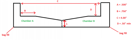

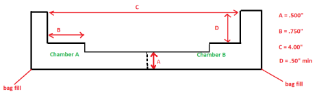

I sent these to Edgewood several years ago. Also asked about having each of the ears have their own fill chamber so the sand won't migrate.

I sent these to Edgewood several years ago. Also asked about having each of the ears have their own fill chamber so the sand won't migrate. Last spring they came out with these:
Thank you Sir !!.....Exactly what I was wanting done !!
