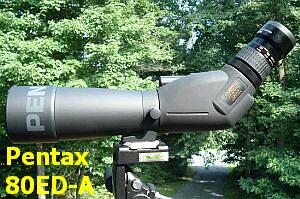

For the price, the Pentax series 80ED offers great performance and the best eyepieces in the price range.

The Pentax in the MOd's pic is also a dandy for the $$ as well.
