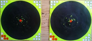

If you're wanting to spot .22 cal holes at distances of 500 yd or beyond, I would simply suggest using Shoot-N-C (reactive) targets. For many years I have used the 18" Shoot-N-C targets for practice at 600 yd. I black out all the lines/rings and numbers, leaving only the red aiming dot in the center. I sometimes inscribe scoring rings of the appropriate diameter using a compass, which only inscribes a very thin, but visible line. That leaves a very nice high contrast black background so that bullet holes that might fall across a line or number won't be obscured. Using such targets with a fairly decent spotting scope (Vortex Razor 85mm), I can readily see .223 Rem bullet holes at 600 yd, unless the mirage gets really strong. Even with very strong mirage, I can readily see .30 cal bullet holes. Below are a couple images of 600 yd practice targets with a .223 Rem using 90 VLDs (left) and a .308 Win with 185 Jugs (right).
