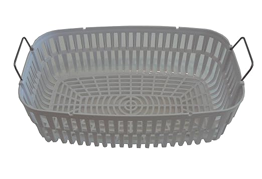

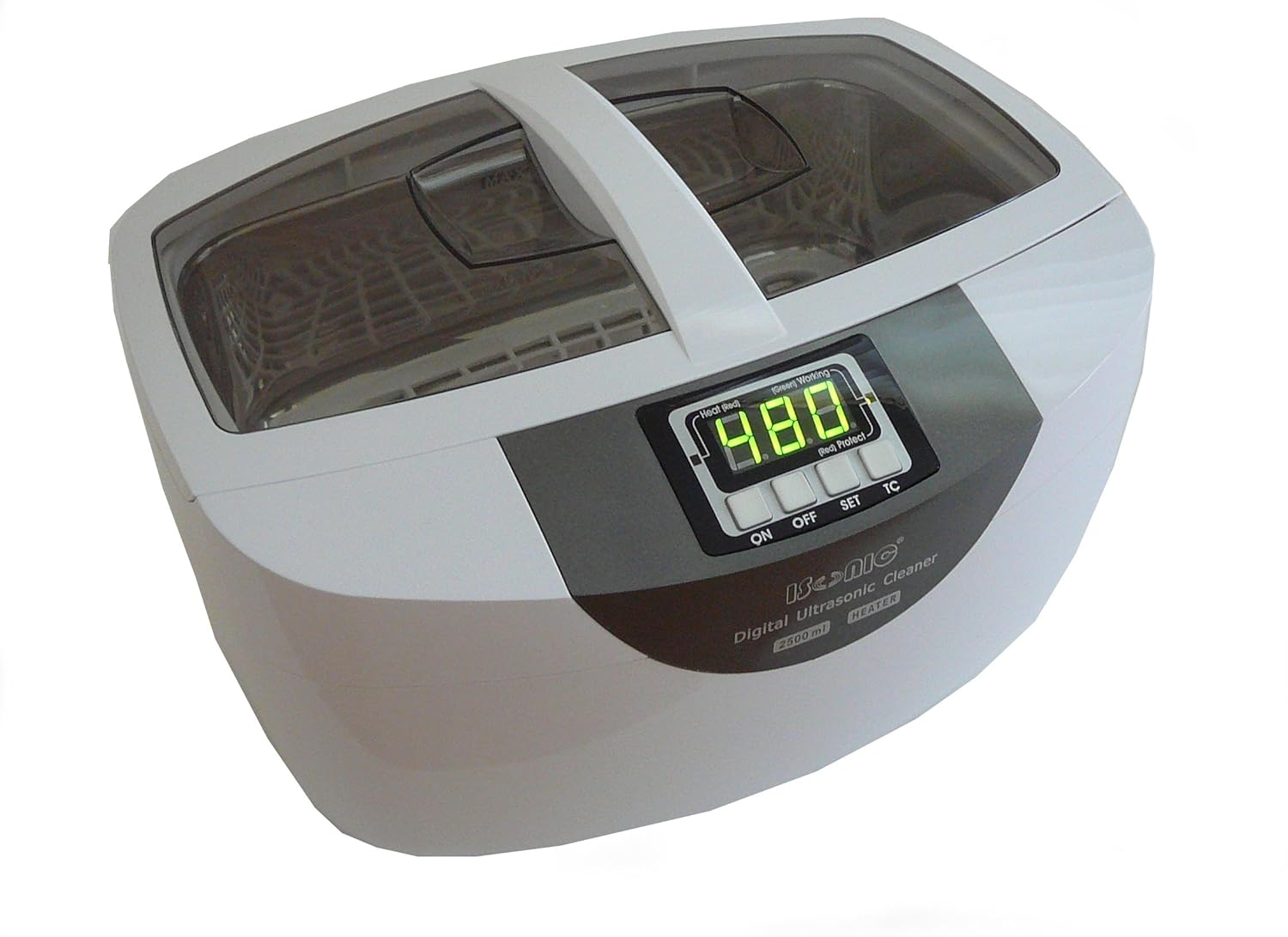

And if you are going to use anything that makes the cases wet with solvent or water then a sonic cleaner is the best choice with dishwashing liquid and a little LemiShine. No dust or media stuck in primer flash holes or peened case mouths.
I bought the Lyman clone sonic cleaner below and like it better than my vibratory tumblers or wet tumbling with my STM tumbler.
iSonic Professional Grade Ultrasonic Cleaner P4820-WPB with Heater and Digital Timer, Plastic Basket $87.99
https://www.amazon.com/dp/B009B2BIKY/?tag=accuratescom-20
