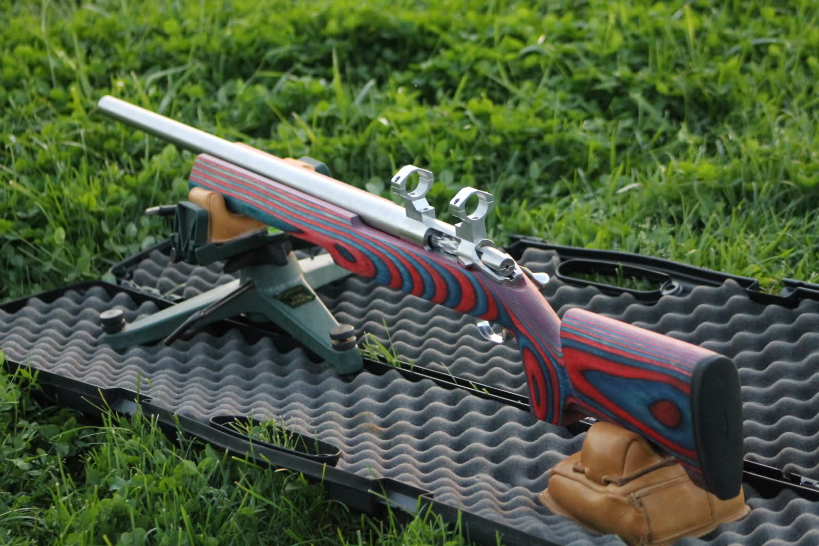

Bat SV 6BR Dual Port with Right Ejection
Shurley Brothers Lowrider stock
Brux four grove 27" 1-8 twist .272 Neck
Jewell trigger
Steve Hoskin did the barrel work and Tom Shurley headspaced and assembled it.
