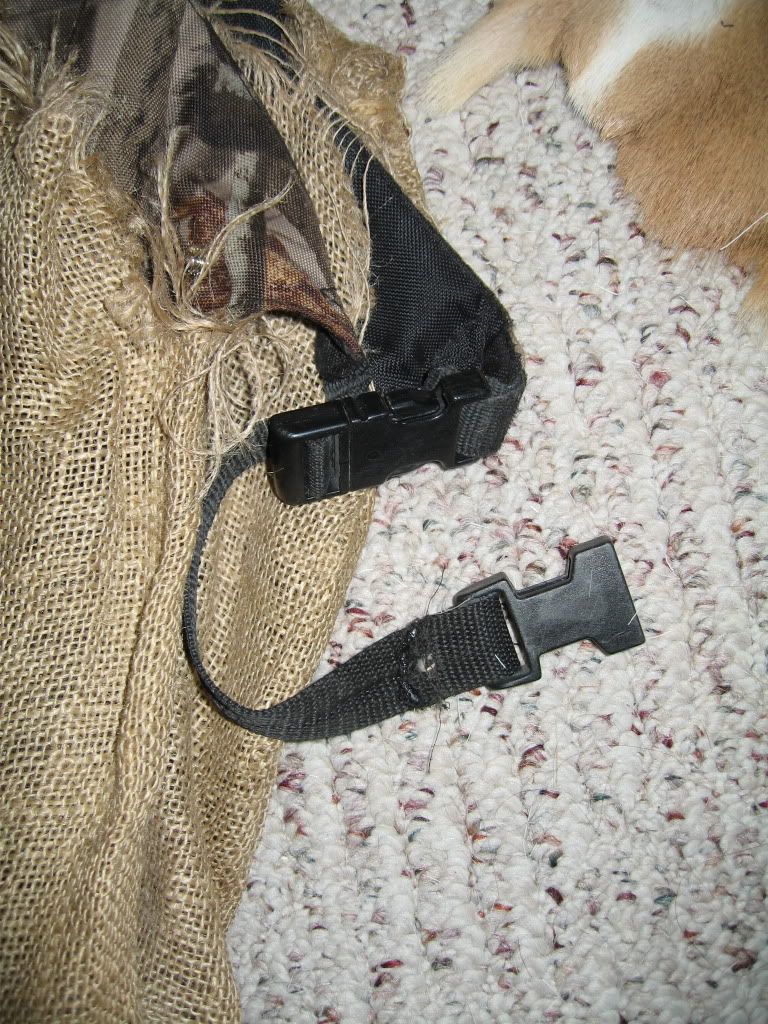

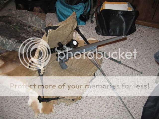

Lawrence--forget the RA Barker--get a soft-sided stadium seat, reattach the female end of the side strap snap as close to the seat as possible for the steadiest of back support, slide it into a burlap bag, cut holes for attachments, sew back up and most importantly attach another snap to the ends of the side straps to carry hands-free around your waist for long walking hunts (as can-barely-be seen in the photo above of buddy Mitch)--
