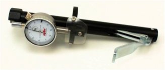

Look at the frankford arsenal hand primer. It's comes with all the shell holders you might need . It has a adjustable dial for seating depth..
I really enjoy the one I have.
I picked one up. I enjoy using it a lot. Its easy to use and adjustable. I have too many problems with neuropathy in my hands so I just didn't think my hands could take picking up every primer individually. So this was a good option. Well worth the money it cost IMO.
