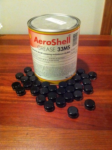

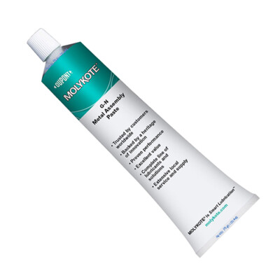

High pressure grease, rated to take some temps are good
I like these two:
