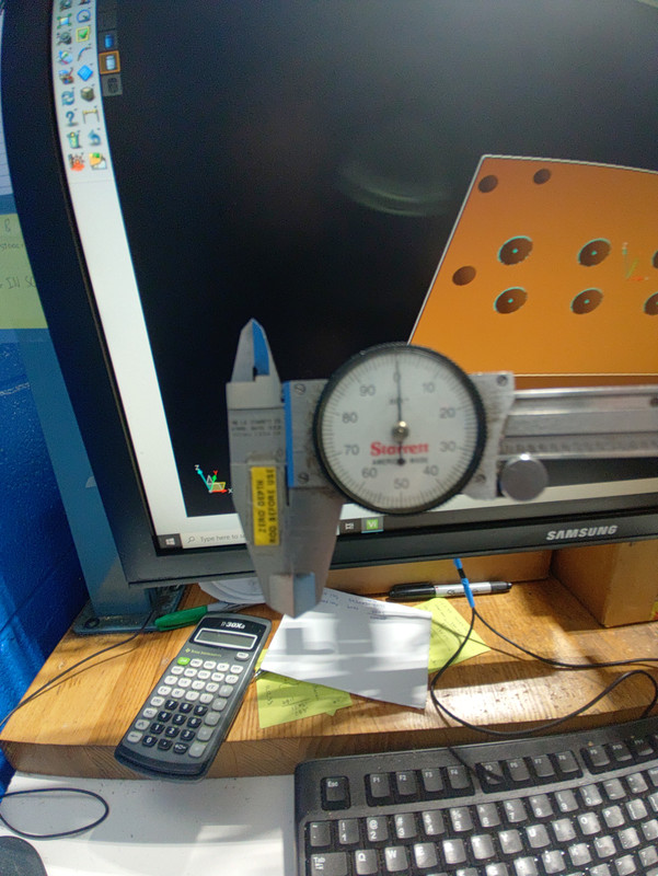

These are about 30 years old.
And still just dandy.
