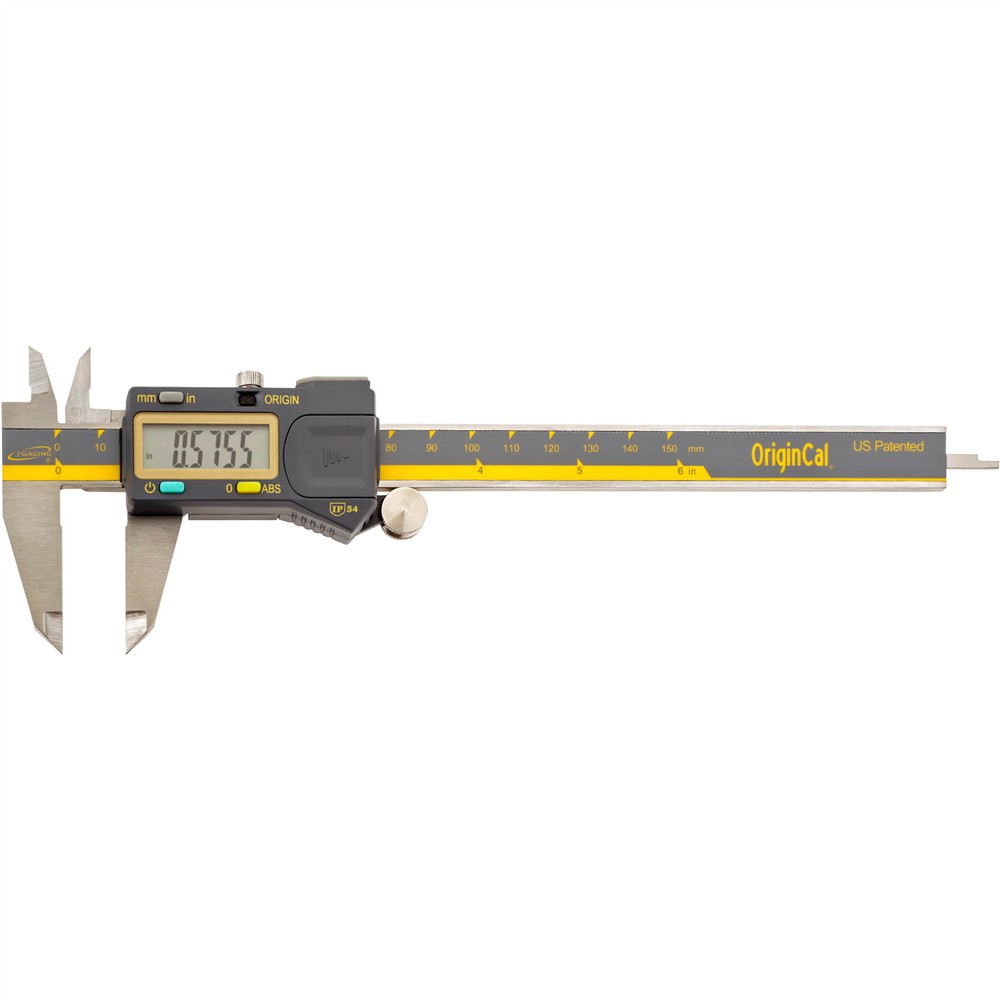

https://www.amazon.com/iGaging-IP54-Absolute-Origin-100-700-06/dp/B00KDUD67G/?tag=accuratescom-20
I have had these for about the same period.
These also do fractions and have the extra base to clamp on to measure depth on bigger objects.
