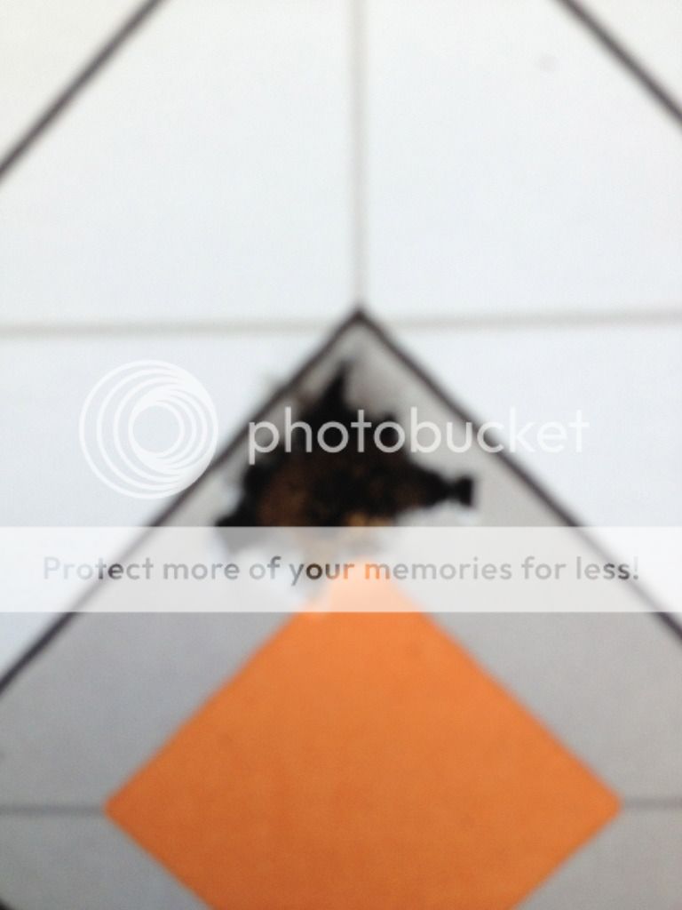

I have had good luck with the new AR Comp powder and the 155gr Sierra Palma. Last 100 yard 3 shots. Mine has a 20 inch barrel and the load is running 2740fps

The 20" SPS Tac shoots great for an out of box rifle (I'm normally a Savage fan). The best group that I ever got was just under .3 MOA at 100 (under .3")
The load I used was:
168g Hornady Amax
Hornady Match Brass
CCI Primers
42.5g IMR XBR 8208 (42g gave me slightly wider group).
I shot that group off a bipod too :)
You might want to try some Berger VLDs if nothing else is working or some of their other bullets in the 155g range. For a 1:12 twist I wouldn't be going over 168 but the 168 Amax shot awesome for me.
