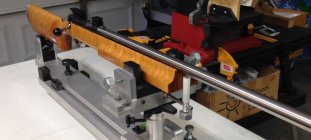

I shoot a 1976 Anschutz 1413 (MN54) in it's original stock. One problem with that stock is that because it was designed for 3-position International competition, it has a significant amount of "cast" built in. To make it work for benchrest, I built a custom rear bag rider that attaches to the butt plate base, that is parallel with the centerline of the rifle. I have also had it rebarrelled with a Shilen "ratchet" and had the trigger modified to 2 oz. It will definitely out shoot my capabilities, with the right ammo.
