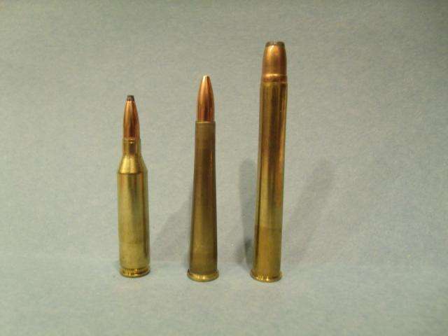

Sold my RC in the 80's and have gone through a number of presses, a C&H Magnum, C&H four station, Pacific C, Lyman American, two more Lyman turrets, a big Herters and my set up now is two Lee cast 4 hole turrets with the auto index removed a A Lyman Crusher that I keep set up for serious case forming and bullet swaging, I need to swage .264 bullets down to .260 for an old German drilling that I use for coyote hunting.
Serious case forming center 6.5x58R from the 9.3x72R on right.
