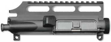

I use the Rock River EOP uppers for my 1" bull AR's. I use low
profile Burris extreme rings
