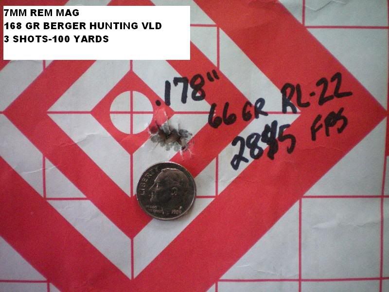

I had great luck with the 168gr Berger VLD in a 7mm Rem Mag using 67gr of RL22. Only traveling at about 2950 fps from a 24" 1 in 10" twist barrel with 5R rifling but with 66 gr of RL 22 my 3 shot group at 100 yards measured .178" CTC and with 67gr of RL22 the 3 shot group measured .133" CTC. Both just oblong one hole groups. Amazing accuracy.
jesus!!impressive!
me too i have twist rate 1 in 10", but 26" barrel. in italy i can't find alliant powder but burning rate o f rl 22 is very similar to mrp or vithavuori n 160, i hope to have luck, i use a steyr rifle and one made by an expert gunsmith
