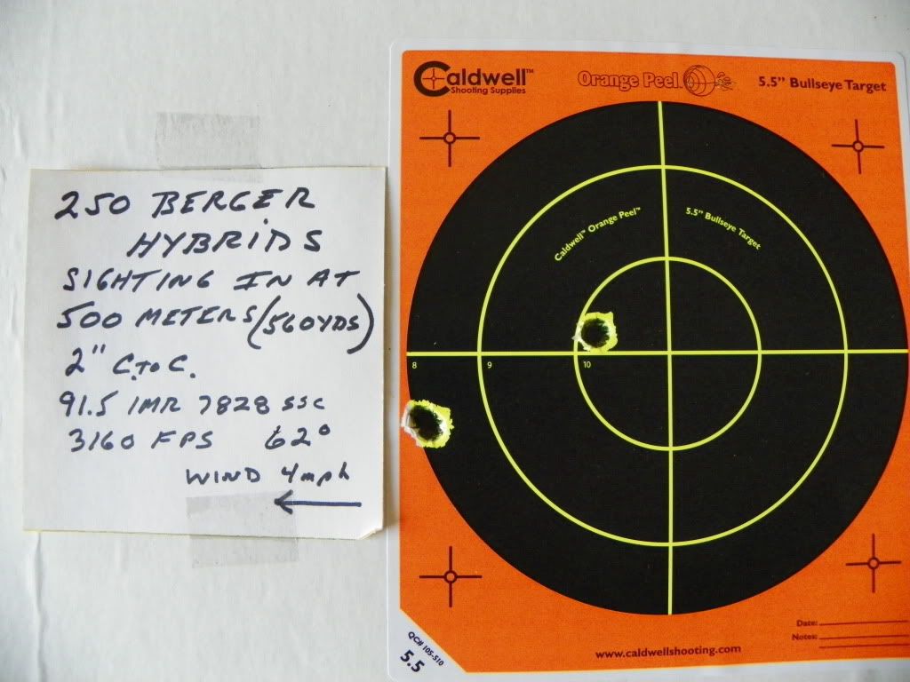

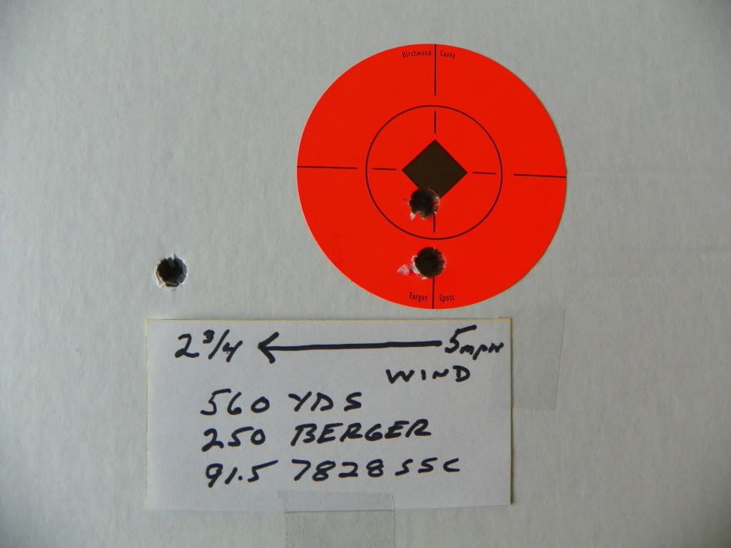

This pic should keep you interseted. The final tests were shot at 560 yds. the longest distance I can shoot at my range. This group was shot at that distance with 91.5grs of IMR 7828SSC at 3160 fps. It was sighter group for testing to get on target.

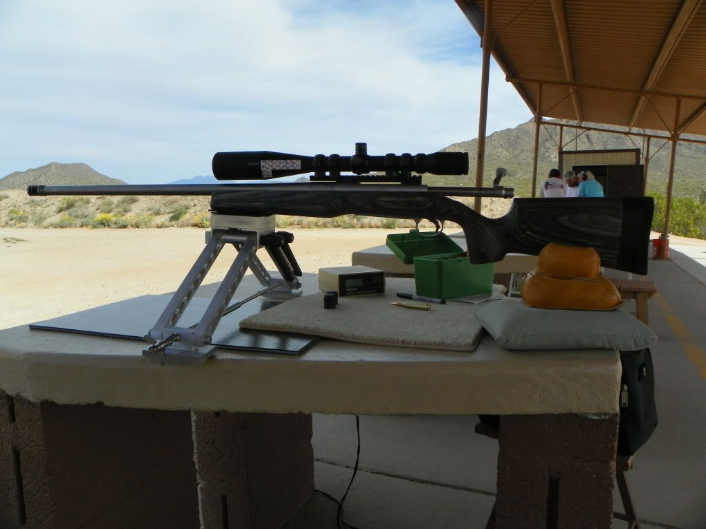

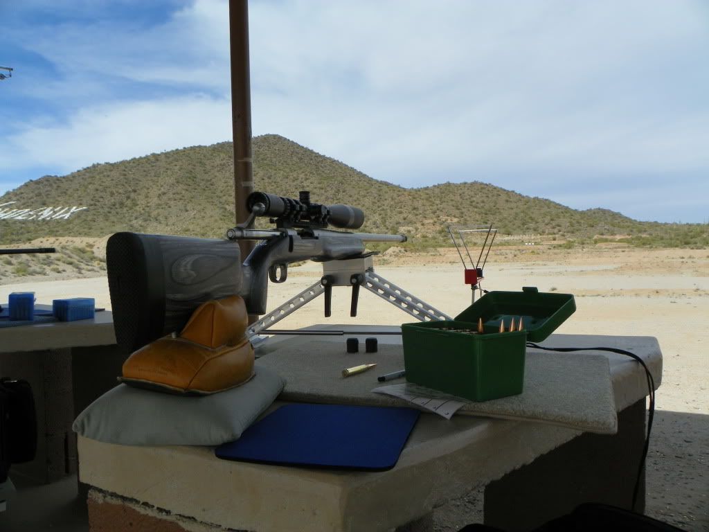

My rifle
Rem 700 with a 30 inch Broughton tube 1:9.3 twist with a Muscle brake chambered and installed by Jim See @ Centershotrifles.
Canjar set trigger
EGW 20 moa base with 4 Burris Signiture Z rings Holding a Burris 8x-32x-50 Black Diamond
Bobby Hart LRT stock Devcon bedded by ME.
Bipod custom made by myself.

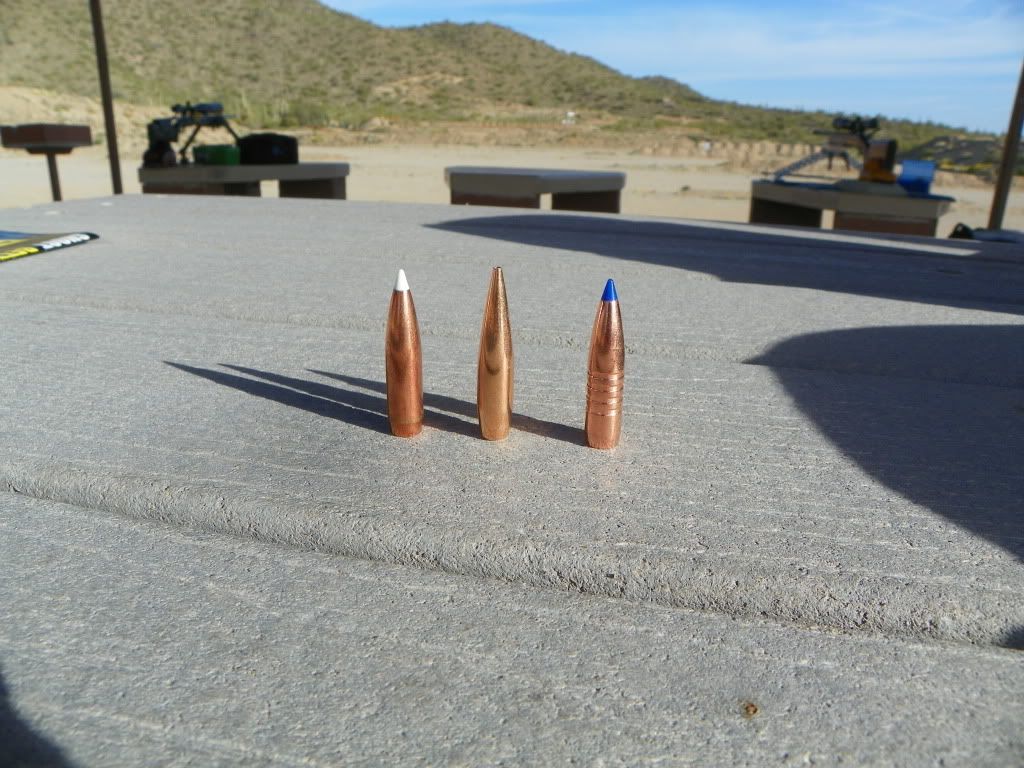

Here is a pic of the bullets I have shot before
250 Nosler AB 250 Berger OTM 225 Barnes TTSX

Testing was done at 300 yds. The 90 gr produced a 1.034 3 shot group at 3020 fps.
I tried some more at .015 and .070 off the lands with the 90 grs and the .070 produced a group just under an inch at 300 yds. I loaded some more up with
90.5 91 and 91.5 grs and the 91.5 gave a little more velocity and grouped as well 3 shots at 1 inch at 300 at 3160 fps.

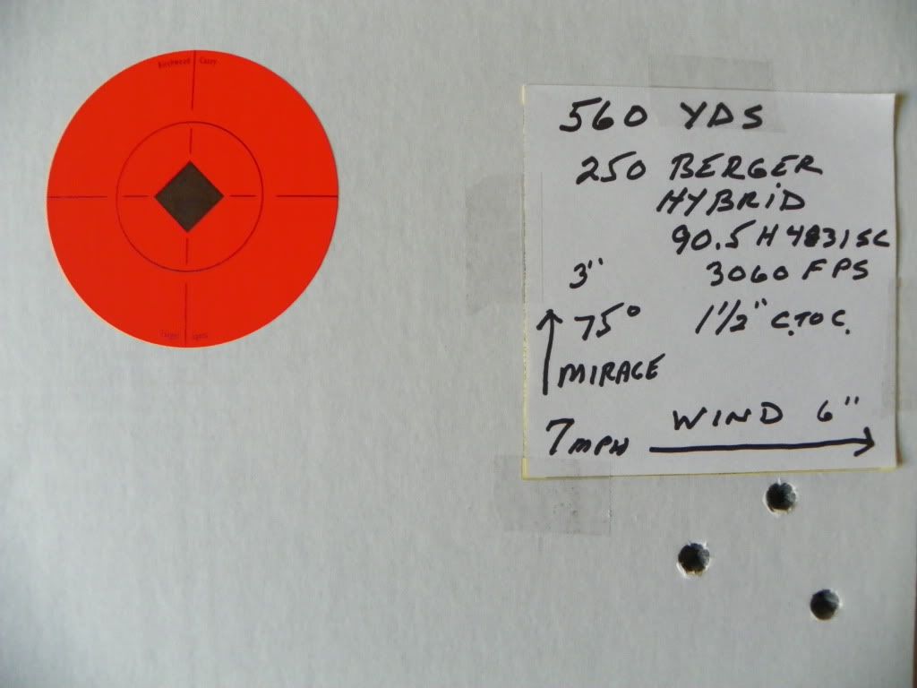

I also tried H 4831SC
Fed 215 Mag primers
I loaded in 1/2 grain increments from 87.5 to 90.5 gr seated .070 off the lands.
The 90.5 grouped the best despite the wind and mirage that day with 3 in 1 1/4 inch at 300 yds at 3060 fps. I know I can still go higher with the 4831 but with the amount of bullets I was given, my load development was limited if I was goint to stretch them out to 500 Meters.
I loaded up 15 with 91.5 grs. IMR 7828SSC and I loaded 10 up with 90.5 grs. H4831SC for my testing at 500 Meters ( 560 yards at my range )

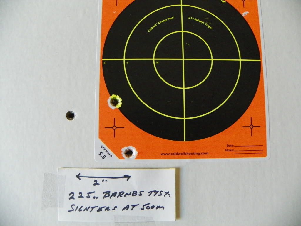

I used my go to load of 92 grs. of H 4831SC with a Barnes 225 gr TTSX at 3217 fps to get on target at 500 despite 3.5 to 6 mph winds.
I had to come up 6 MOA on my scope ( 48 1/8th clicks ) from my 300 yard setting to get on at 560 yds.

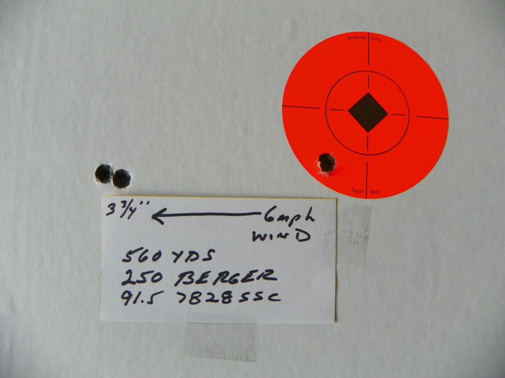

I shot three 3 shot groups with thw IMR 7828 SSC first letting the barrel cool down to outside temps between shots. Temps started out at 62* and wind was from right to left from 3.5 to 6 mph. These first 2 groups would of been really small if the wind didn't play havock with my testing.
I really like how these bullets show very little verticle variation.
I then shot the ones loaded with H 4831SC. The wind had changed directions and the mirage was moving my 3 inch orange dot around about 3 inches. The temps were at 70* and the wind was from left to right now. I tried to shoot when the wind was blowing the mirage away so I could get a more accurate ainimg point. I even cut the power down on the Burris to 24x.
This was the last group of the day and was the best with this powder.
