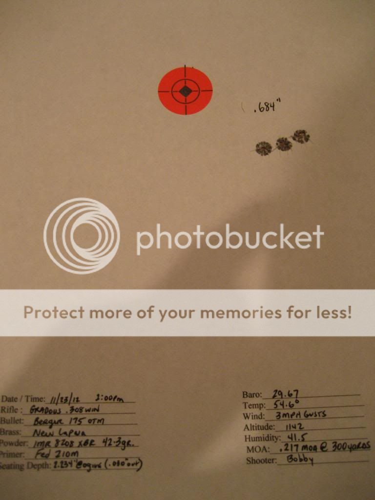

While doing load workup in my wifes rifle (Gradous Surgeon 20" 1:10 .299/.308 Bartlein) I shot this 3 shot group at 300 yards with 42.3gr of IMR 8208 XBR / Fed 210M's / New Lapua brass / Berger 175 OTM's seated .030" out of the lands.

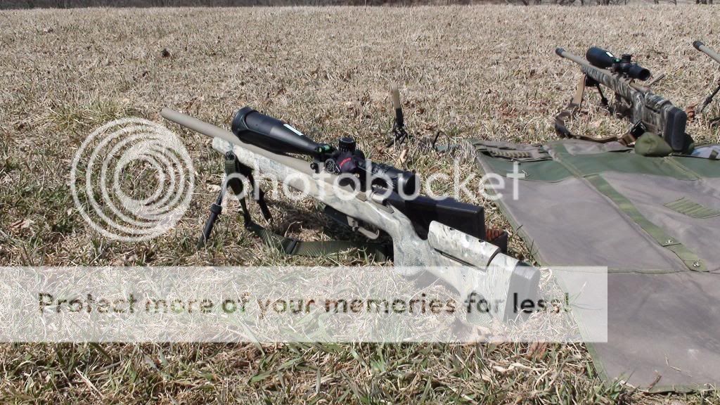

Here is the rifle:
