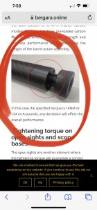

Well, the carbon tube that goes around the steel barrel turned almost with no resistance. So I kept turning and it threads off to reveal a small diameter steel barrel underneath. I’ve since learned these are “tension barrels” and this is part of how it’s built. I always thought the carbon wrapped right around the steel, maybe some do.
So…..after reading some more online I found out that Bergar recommends 124in/lbs of tension on this carbine tube.
I believe what happened to mine was as I was threading the suppressor on and off I lossened this and created my issue.

I have to get a spanner wrench and torque to spec. Bergara recommends 124in/lbs
I also believe if a guy knew a good machinist you could experiment with an aluminum or even a steel sleeve that replaces the carbon one.
Might be a waste of time but it could be quite fun.
What tool do you use to tighten that?
It looks to be a spanner wrench that would have pegs on it. There I are two holes opposite of each other on the front of the steel that is attached to the carbon.
A guy would need to have a way to hook at torque wrench to it.
124 in/lbs equates to 10.4 ft/lbs.
