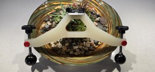

Here is a bipod design I came up with and machined myself with my CNC. It is very solid and micro adjustment for level and height. The ball feet screw off and that leaves sharp dig in points, but with a rubber mat, and the ball feet it stick very well. Think I'm going to start making and selling them. I used the ARCA rail setup so it is an easy on/off and adjustment. I won a 100 yard PRS match with a score of 487 out of 500 first time out with it. Was vary happy and way more stable then my Harris bipod or the Caldwell Rock tripod I was using.

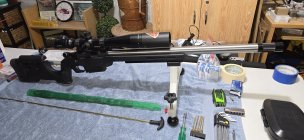

Just installed a KI Precision profit barrel last night. Was getting late and only got to send 10 rounds down the pipe. No jams and feedings without issue. Going to sight in today.
