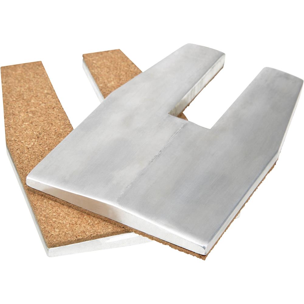

They also sell a set of soft jaws that fit it, works pretty good, I use it on my knifemaking bench.
