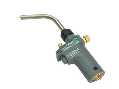

I had trouble setting up my 20# tank, hose and regulator set up with about 5-6 different torches I had in the shop. They either wouldn't light or didn't burn hot enough.
My son in law owns a plumbing business and got me a Turbo Torch.
Man it's the cat's ass. I now set my Ugly Annealer at 90 and a perfectly annealed 223 based case spits out every 3.2 seconds.
The Turbo Torch flame envelopes the entire neck which turns a nice ruby red and the shoulders set back equally upon resizing.
