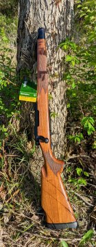

Hello everyone and I'm sorry if this is beating a dead horse. I have read and reread post after post and looked at chamber drawings till I am blue in the face. But nothing is giving me the straight answer.
I am wanting to build a 6br on a Remington 700 in a old BDL stock. Make it a short suppressed varmint rifle. I have the opportunity to buy over 200 factory Remington 6br shells and I want someone to tell me, will a 6br norma chamber except these factory loaded rounds? I like the thought of shooting the factory shells but I know I will also buy brass, probably alpha down the road. Also will not want to turn necks.I don't plan on using the long vld 105's, I have a dasher for that. I ordered a 1:10 shilen barrel and plan on shooting the 68 to 90 gr pills.
Measuring the factory loaded rounds( I bought one box for the ammo collection) oal of the brass is averaging 1.557
I appreciate any input.
Thanks, Keith
