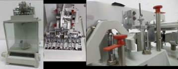

Years ago I had a Sartorius 2442 like this pictured below. It was a gift from a University Professor I used to shoot with.
For all the complexity and engineering, it could hold accuracy levels people seem to be expecting in this thread.
You guys need to be realistic about the accuracy expectations of single beam scales.
Since the old days I graduated to a Sartorius digital balance that weighed in increments of 0.02 grains, then I upgraded to a Vibra HT220 balance that increments in 0.002 grains.
So, having considerable experience on this subject and with the capacity to weigh very precisely, I have evaluated the performance of several beam scales and I can assure you that accuracy of a beam scale that is within 1/10th of a grain would exceed my wildest expectations... and I have never seen such a thing.
The German engineered scale below might on a good day, but it was fuuusssssyyyy.
There's alot of trash talk here about digital scales but in all cases you get what you pay for. All digital scales are not junk, but there is alot of junk in the price range most shooters are willing to consider.
Once you get into $1500 and up, you are getting a very reliable balance, especially when it has internal calibration like mine. Its a fantastic experience that I hope some of you one day can enjoy.
