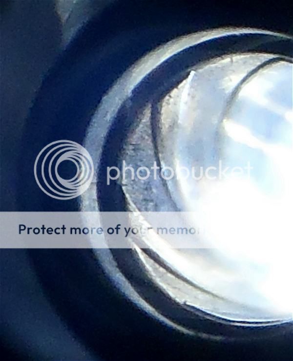

Win94ae: Nice pics. Wish I could get them like that. Do have some special photo equipment?
Nothing special, it is an Olympus Tough Tg-310 camera, ($175.) I put a flashlight at the muzzle and take the pics from the breech using the optical and digital zoom on the macro setting.
Someone asked about the ring privately and I thought I would post this picture here displaying a carbon ring. I'm not quite sure that the message was sent properly.
It is hard to see since there were only 20 or so shots taken without cleaning. The 30-30 probably doesn't leave a great of a ring as some of the barrel burners do.

Win94ae: great photos! the "carbon ring" in the last few thous of the neck portion of the chamber is obviously different from the carbon deposited in the bore and more difficult to remove. the ring in the chamber is very easily seen with the hawkeye viewing at a right angle or perpendicular to the chamber. your photos are at an angle and i wonder how much of the "ring" in the photo is actually a shadow from the bore light shining over the very short 45 degree angle that transitions the neck portion of the chamber to the freebore. perpendicular photos of the ring before and during it's removal would be very educational as to the resistence of the ring to removal. i have done so with my hawkeye and noted it's gradual removal.
