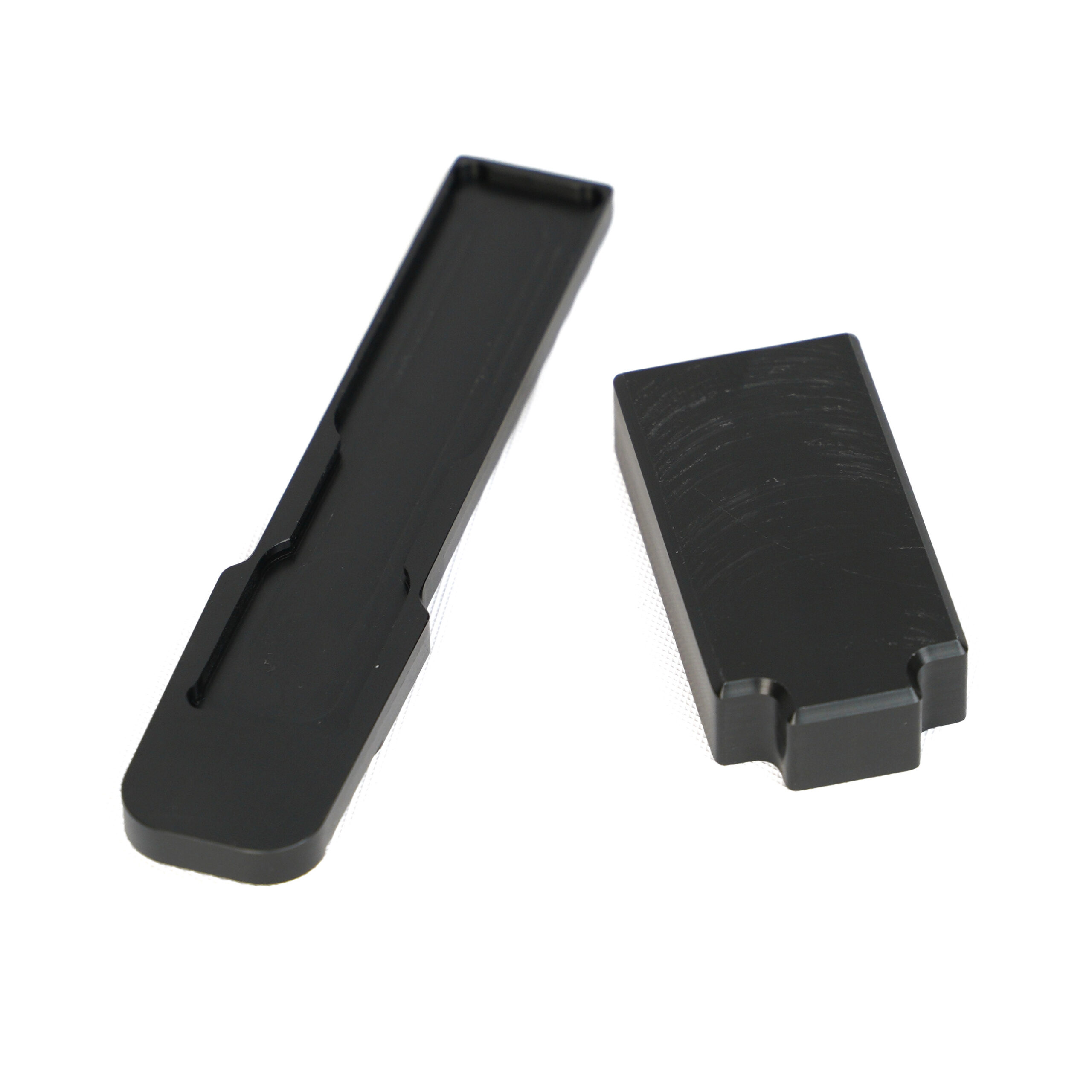

Below is a picture of Hawkins M5 DBM on the igniter I pictured in the earlier posts. With the caliber he selected in this long action we had to install the spacer kit which made it feed way better.
I hardly ever do pre-fits so I can’t help much on that. Might reach out to Unknown Munitions and see if they could spin one up and install it right on an Igniter they have in stock.

You mentioned it’s a long action with a spacer kit. Could you elaborate on the details of this ?
The chamber was 25-06. I installed the Hawkins spacer kit to reduce the amount of length in the magazine and changed the follower so the ramp would “pop” the cartridge up quicker. This gave better feeding with that particular cartridge.
spacer kit,
