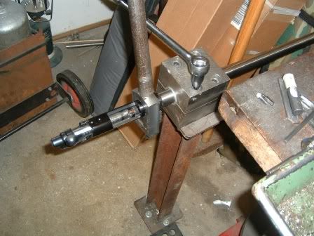

When I make a Rem700 action wrench, it is like making a barrel vise with a long handle.
  • Rem700 round action wrench with bushings and barrel vise mounted to bench with bushing.jpg
this is one I made a number of years ago; it shows the action wrench and the barrel vise.
