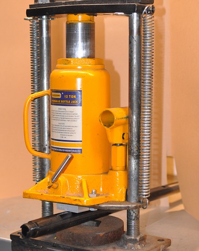

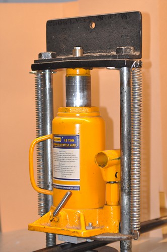

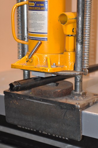

I built mine using two 1" bolts 15" long and three steel plates. The heart of it is a 6 ton bottle jack and blocks cast from pure lead. If you want pictures, PM me with your E-mail address (eiser to send pic). Hundreds of Remington barrels removed with out heat.

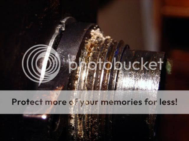

Todd must have run into one of the ones that look like this inside, and you will not take them off with out heat, period !!!!!!
I've taken off thousands of them and 99% of them do require heat to loosen them up...

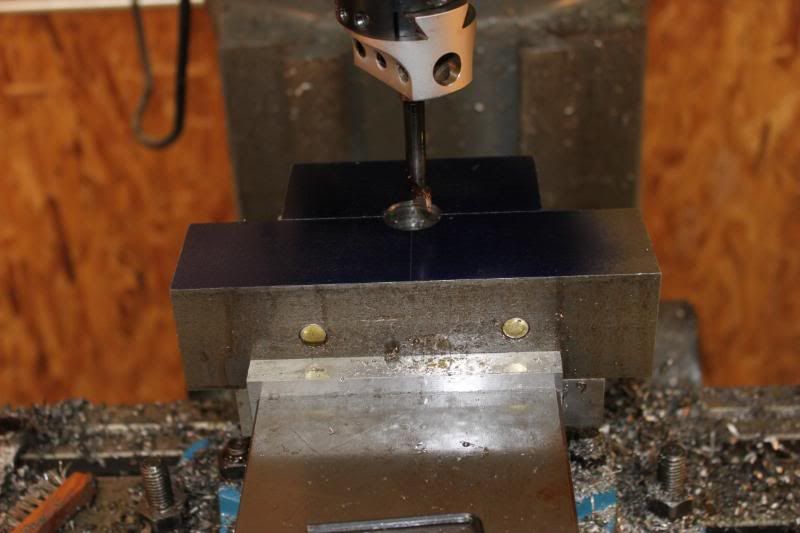

Finally started making my barrel vice. Finish boring hole for bushings and drill two holes for 3/4 mounting bolts. Making aluminum bushings will be next hurdle.
Mike,
You need to take it out of the mill and put spacers in and rebore. If you make the bushings to fit your hole as shown it won't be able to tighten down on the barrel.
Butch
