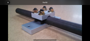

I split the top in half. The generous holes allowed the pieces to somewhat follow the contour. In effect have 2 vise clamping more areas of the barrel.
Never had a barrel slip including Tikkas, and Remington factory barrels. Support the action with 2x4, using a wrench that grabs the lug, whack the wrench handle.
Brass rod is just for demo.

Even on my legacy vise, I replaced the top with 2 pieces of aluminum barstock. I elongated the holes to allow max tilting. The vise had be to mounted higher off the table for the front end of the barrel clear the table top.
