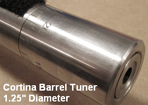

I do not own a tuner, tho I do shoot brakes, but believe this makes sense.
You can sure enough tune a barrel with what it cost for a tuner and a smith to put it on. If you have your own reamer the new barrel will shoot the same load, right out of the box. All my barrels are chambered with the same reamer with in a .0005 different makers and different guns all shoot the same load. So now talk time and cost effective……….. jim
Almost everyday I read the bulletin here. Often times the bulletin features award winning guns. I have never seen one with a tuner. There is no national or world gong championships. I will listen to someone like Johara1 that can shoot others 600 yard group size at 1000, in official standards.
Jim, what tuners have you owned and would you explain in detail how you adjusted them, respectivly? You keep on harping that a gun can be tuned to shoot well without one....nobody is arguing with that.
johara1 said:
Harrells ………. tuner brake…. jim
Jim, unreal, man! You said in the pm that you sent me that you didn't want to brand bash...and then you call them out out by name. Then, you didn't answer the rest of my question.
Yes, they add weight and no, if you're tuned to the hilt without one, no tuner will make it shoot substantially smaller. Again..no one is arguing that point.
Frankly, while you may be one hell of a shooter, it's clear that your experience with tuners is very limited....but you bash all of them.
You called tuners a crutch a few posts back. I guess power steering is a crutch in Nascar, then.
Your opinion has been made clear here. No problem. But there are many, and a growing number at that, I might add..that see tuners differently than you do and do have a lot of experience with them, too.
If tuning by powder charge and seating depth, etc. works for you, by all means, don't let tuners stop you from doing things the way you want to do them.
Yep your right, i shouldn't have mentioned one brand. I'm not bashing them in short range, but they all work the same not one better than the other. Do you shoot a 600 or 1000 yds?. ….jim
Would you have different settings for different distances?
How does it vary with temperature and altitude?
My competition rig has different settings for different distances to the target. I've put the main node at the muzzle by adjusting with the tuner, done a ladder test, and then doing 3 shot groups at different distances turning the thimble 1/16th of a turn per group.
The rifle likes a setting for each distance being able to shoot between 0.2 to 0.3 moa 5 shot groups while on those particular settings. If using the setting for a different distance (at the same rifle range) , it opens up to 0.75 to 1 moa.
What is your experience?

I'm on same boat that it really comes down to bullets and barrels. Properly done, a tuner may help, but since we can tweak loads, one would have to weigh the benefits of simply loading a few more loads above and below the "load" versus loading the same load and tweaking a tuner. One must have to determine if the additional cost is worth it as well. For people that do not have their own set up to turn barrels, it could get pricey to add tuners to the end of barrels.
I remember someone mentioning that adjusting powder is like adjusting the tuner. Not sure on the validity of that saying, but it makes sense. we are simply changing the harmonics to get as close to the desired position on the barrel whip. Do it with the load or with the tuner.
John Meyers, who just won the F Class mid range nationals yesterday, uses a tuner and so does other top F Class shooters. But there are many that don't use a tuner either. I know John Meyers has a method to the tuner madness, but I bet many of us, myself included, would be setting the tuner in the beginning and most likely never touching it during a match. So, why not just skip all the complexity and develop a good load, in a wide window, that can shoot in multiple conditions?
That being said, I have never used one and have been thinking about trying one just to try it. If i did, it would look similar to Erik's design. Maybe I should draw one up and have it made...o
Why would someone put a tuner on a gun and not use it . Larry
what I meant is i think people would put it on, develop a load, tweak the tuner, then never touch it again afterwards. people can do the same thing with tweaking a load. John Meyers tweaks his tuner ever relay it seems and I would have to assume it is based on data that he has collected over many years and lots of testing.
If conditions change then turn the tuner .
They are easy to use takes a little learning.
Over 6 years I have used the RAS tuners . I don't have a gun without one .
I have the first one we ever made .
I could be a little bias but I feel we have the best . Larry
