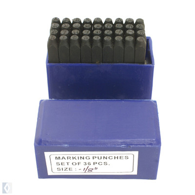

Stamps are pretty cheap, You can do a good enough job yourself to caliber mark your barrels, Don't waste your money on Chi-com stamps though, They generally aren't hard enough to stamp steels.

Nothing wrong with stamping. It can look just fine if properly done, using spacers where needed and making sure you get the jig perfectly parallel to the barrel so it doesn't end up crooked.
You can get the LaBounty jig, but when I used to use stamps I just made my own from two pieces of aluminum angle and a U-bolt. Easy-peasy.
Hardest part about stamps is remembering 1's don't require a hard strike. 8's you'll probably have to 'wack' 3 times.
