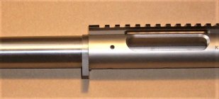

Getting ready for the Anderson Creek season. As I've said in the
past, I no longer use a nut. Arguably (as this thread has shown),
a shouldered barrel is superior in many ways......Of course in my
opinion.....
Brux on a Savage PTA. Life is good.....:D
