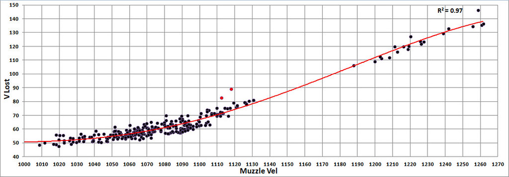

Hey Tony,
I'm not sure I've really explained why lot numbers shoot differently, just given maybe one of many possible causes.
I've visited with Ivan Wells a lot over the last few years and he's gone to incredible lengths to identify some possible reasons for the differences in lots, but you can't test it reliably because in most cases you destroy the cartridge while measuring what may be the most important differences. It's a conundrum I've yet to find a solution for yet.
I'm glad you elaborated in a later post regarding how you're using the chronograph because if I hadn't been busy I would have posted that's there's always nearly a perfect correlation to MV vs downrange V and you've accomplished nothing. The correlation is nearly perfect for the two in that the higher MV always results in more V lost downrange. When you reported you did it only when the avg MV's matched each other, it confirmed you hadn't made that mistake.
You and Graham may find this interesting.
It entails an incredible amount of work for me to set-up in my tunnel for calculating drag coefficients and converting them to BC (Ballistic Coefficients) and the last time I did it was in November of 2015.
I did a search for that data and then made the following Excel chart based on 15 lots of mixed pedigree ammo and varying avg V's, with each lot consisting of 20 test shots.
Landy
