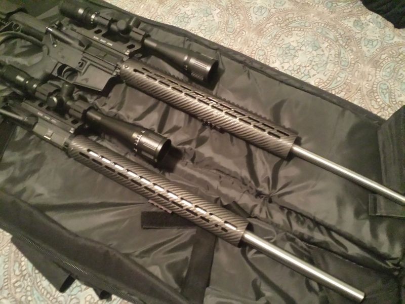

My 20P AR is built around a 24" BHW in spr profile, .750 gas block. Good medium weight without all the extra mass like my 24" heavy bull match barrel on my prone upper. Doesn't string like a real light profile does when hot either.
The top one is my .20P, I'm pushing 32vmax just at or over 4k with IMR4198.

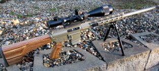

mac86951 - My .22-250 is an AR10, I put that gas port 17" down the barrel, that's rifle length +5" and am quite happy with it. +4" probably would have been enough but this is very easy on brass. I know Gene designed the system to work with a port pressure of 19,000 psi and that as bore gets smaller relative to case volume that point moves further down the barrel. Quickload would help here but I don't have it.
jepp2 - My AR10 with the 27 and Nightforce scope weighs around 13# and it's a bit heavy for a walk around varminter. My son's 16" AR15 is what inspired me to build the .20 Practical, it's so light and handy and is death on Prairie dogs out to 300. So probably want to keep the barrel lighter on the Practical. My .22-250 barrel is kind of a medium palma taper to the gas block, then goes to .730 to the muzzle. Probably do something lighter for the Practical.
