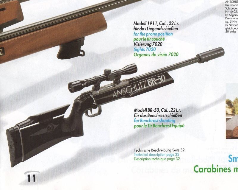

Do you happen to remember when that was? I've never managed to find a good date for the introduction of the 2013, and any info would help. The earliest mention I have is in a report of the 1990 UIT World Championships, and then notes of the switch to nickel-plating receivers in '92, I think.
The tuners seem to be the sight extension tube cut off at the step in diameter.
Tim as you are probably aware the earliest Anschutz owners manual for the 2007/2013 was published in January 1991.
This manual doesn't include what Anschutz would later refer to as the BR 50 model, which appears by at least 1995-1996. This model had the short 50 cm barrel a weighted sight extension. (To be sure, this was not a tuner and had no capacity to be adjusted.) It is not known when this model was discontinued.
Below is an image from a 1995-1996 Anschutz brochure.
There may be further relevant information about the square action in the following, in which the model was considered new as late as 1997 https://www.accurateshooter.com/guns-of-week/gunweek080/
I do not, but years before the 2013 and, to the best of my knowledge years before any representation of any type of BR version, best guess ‘90-‘91
When this took place, my understanding was the BR-50 was in discussion….not offered yet.
Action, I believe, was not nickel plated but hardened electroless nickel …..was harder than case colored.
This I know because when they came they had the action clamp screws plus a 4-40 set screw that indexed on a barrel flat…..which was glued.
Mine snapped and I had a high end machine shop locally that could only get it out using EDM and then new tap to clean it up. Tool and die guy indicated it was some hard stuff.
FWIW, it was in fact a tuner….this I was told from the guys who talked to the Germans extensively trying to import the barreled actuons.the concept of “ adjustable” was to develop here a bit later
