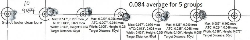

A rifle has to be able to shoot good. then it is on the shooter. here is a Falcon I used for ARA UL these groups were shot testing ammo when you could get lots to test. the first example is not including the fouler group the second include that group. the 20-shot group was with a different lot of CX.
as good as these groups were the best, I ever finished was second place.
I currently am shooting my back up rifle an Anschutz it shoots great, but it doesn't shoot as tight, but I have done way better with it and won a few matches with it. like many have said groups are great but the rifle has to have the ability to put that one shot where you want it to go. sometimes it may not be a rifle that can shoot the smallest groups.

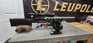

This is an example of what a 1.250 is capable of, Vudoo single shot, 1.250 16 twist Mullerworks/ec tuner in a Foundation stock.
Lapua test results were without the tuner.
