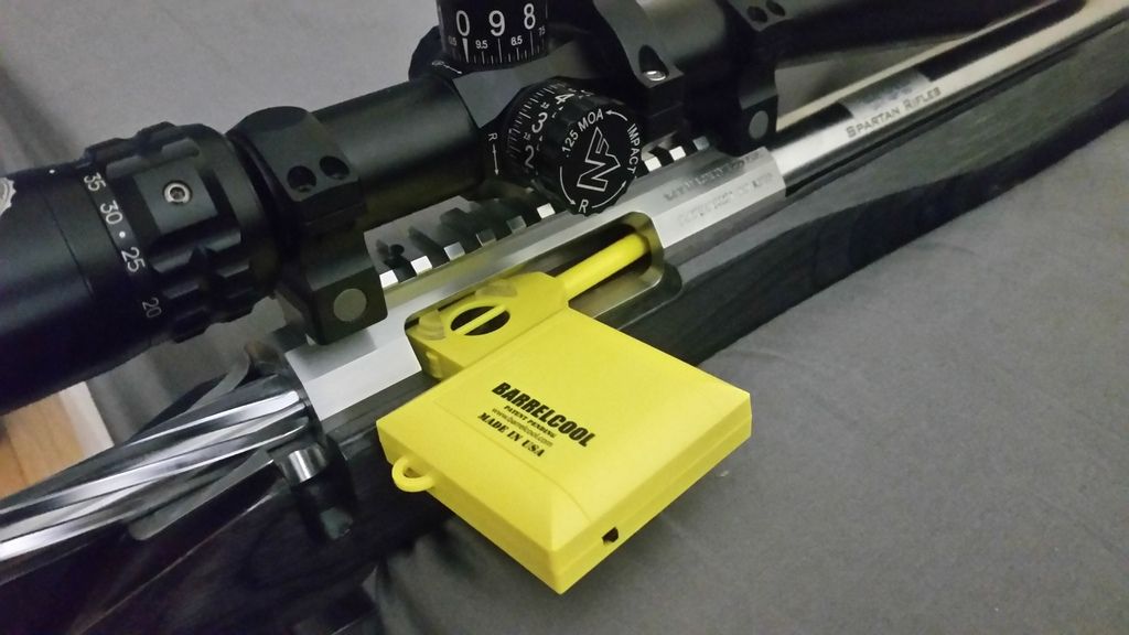

dissenting opinion here. I have used mine a couple times and haven't seen much improvement in barrel cool down times. The last time I was out I brought a IR temperature gun to measure as I thought maybe it was working better than I thought but just wasn't "feeling" it. I alternated using it / not using it over 60 rounds (10 shots per string). After 5 minutes there was about a 1 degree difference as measured about an 1" forward of the throat. After 10 minutes there was about 2.5 degree difference.
My test was fairly simple but I will say I was disappointed. An important point to note is that I shoot a left port gun, so the intake fan points down. Does this affect the results? maybe. Given how many are happy with theirs, perhaps that is my issue.
Understanding that it would take some re-engineering and might not be feasible within the current form factor, but if the fan could be moved so it points out (instead of up or down in the action), maybe that would be better.
As soon as I saw the unit in person I could see that the left port action was going to lay the intake facing the bottom of the action-- which does effect the performance.
My solution was a section of vinyl tubing attached to the existing tubing-- the new vinyl tube fits snugly in the cylinder and provides a good seal so no air loss.

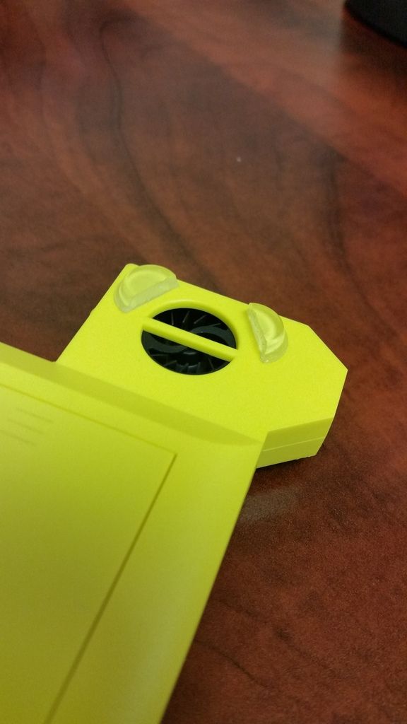

Left Port users of BarrelCool can try adding bumpers as shown below. This will give enough gap to allow for no obstruction of the intake. Adding these bumpers however will not allow this to fit in an AR platform. This will work in both left and right port actions.
