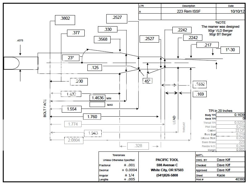

30" M24 contour (or similar) barrel, .218"/.224, 5R, 6.5-twist ( 7-twist will work, but is a little slow for the 90s)
Stock/bipod of your choice that allows you to make weight with the above contour barrel (don't really need a heavier contour than M24 for a .224" bore), most in F-TR are using ski/sled-type bipods with very wide footprints, and a stock with a flat (not angled) toe so the rifle recoils straight back in the bag, which are usually the eared type (i.e. - Edgewood or similar)
Scope w >42X magnification, NF NXS or Competition are commonly used
Enough freebore for the 90 VLDs (will also work w 90 SMKs, see print below)

Get the reamer Greg talks about above with a .169FB. It is a Remington match body with a long freebore for the 90s.
One more time, get the right reamer if you are going to run 90s.

Once again, use the reamer print above.(see a pattern here)
