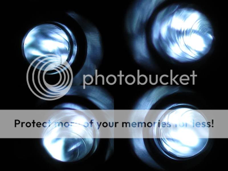

Here is my 28 year old Win94ae 30-30 throat before a break-in procedure. (Not mirror like.)
Here it is after the barrel break-in. (Mirror like.)
The reason to break-in a barrel is to reduce copper fouling; in-which, it will shoot precise longer before needing cleaning.
