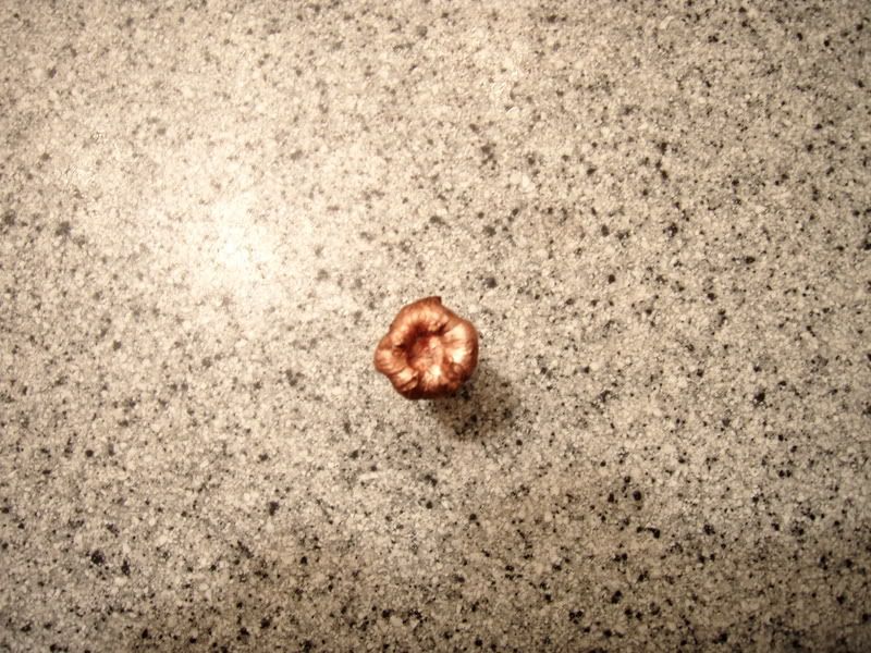

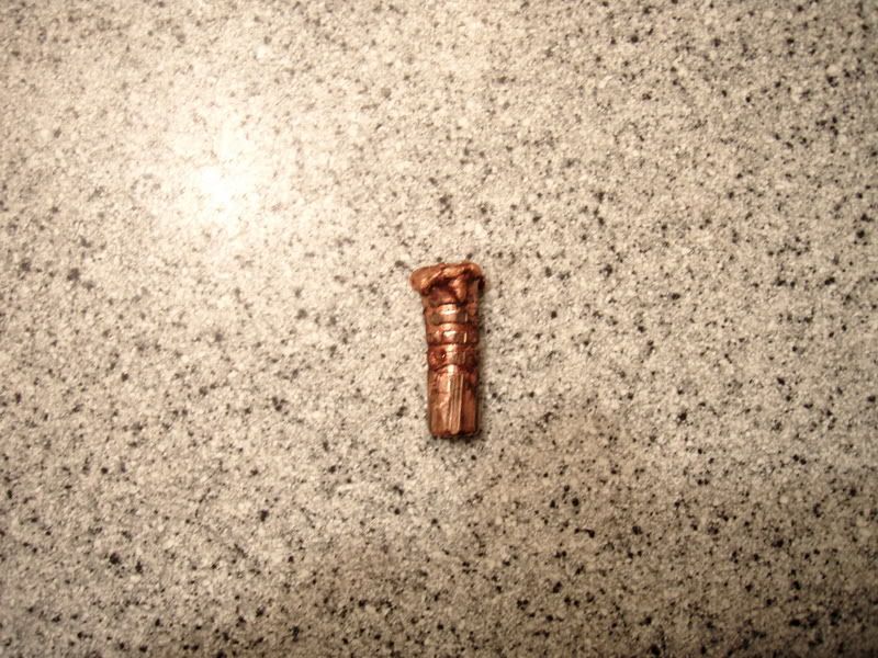

Here are some Barnes 180gr TSX recovered from elk-sized critters (kudu, gemsbok) shot in Namibia with my Sendero in .300WM, ranges from 90 to 300 yards. Several of them broke shoulders or ribs on entry. Retained weights are 94%, 94%, 96%, 100%, and 100% (mean = 97%). Pretty hard to complain about bullet performance, I'd say. There's an unfired bullet for comparison.
